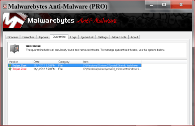

Good mourning. Did I do something wrong or do you see something. I will run Combofix again. I will use the Combofix and post back.
This may help. They are back quarantined.
