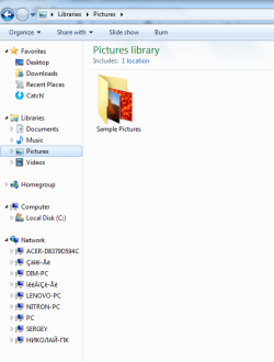

Hi people!
I have a doubt!
First of all let me tell you that I am at home, not at work where it would not be strange if I would detect the presence of any other network users. At home I am sure I don't share anything with anybody.
Well, some time ago, while at home, I noticed that my network was filled with lots of users, and that some of those users where composed by gibberish letters.
I formatted the disk and the problem didn't show up anymore.
However, I started thinking: maybe I was being spied during the time I could see all those users on my network? Maybe it was a trojan or something similar? But a trojan wouldn't be so easy to detect, so it's even more strange!
If anyone is interested, I can post shoots of the situation I am describing, as I made printscreens at the time.
Thank you in advance.

Welcome to the forum. We do need to see how the others were showing and in what ie filemanger. Are you using wireless or cable? One of the problems with staying on 7 is its less secure and out of support so more of a risk

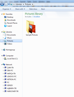

I am using cable. I am sending two photos now (the only available I have).

Those networks are using Unicode characters which seems to suggest to me a Samba NetBIOS mess up or computer mess up of some sort.
I don't use NetBIOS anything and have been turning it off since my XP days in the network adapter. It can be a security issue. Not saying that's what you had, but it's a possibility if you manged to get something on your computer.
For me personally, if I want to share files I use something a hell of a lot more secure, robust and sane without all the complication and overheard. It's called FTP and I have a local FTP server at home. Actually two. It's just a program that runs on a computer. Then I use WinSCP on my other computer's to transfer files back and fourth. With my phone I use the AndFTP App to transfer data to and from the phone and computers. I used to use the Filezilla FTP server program, but now I use something very simple and small called Serva. If you use Serva free edition, just right click the top bar to get the option to minimize.
Keep in mind this is all local FTP, there are no external port forwarded ports. If I need in to my FTP remotely I have a built in VPN in my router which is flashed with the third-party firmware Asus Merlin and I use the OpenVPN App on my phone, make a connection to my home's router and from there I can make local connections. Which means I can gain access to my local FTP server for file transfers. I can also access my local Team Speak server as well with the Team Speak App on my phone to hear my police scanner anywhere in the world where there is an Internet connection. I also have Team Viewer installed and the Team Viewer App to see and use my laptop here that's on 24/7 as the FTP and Team Speak server running my scanner program and what not. It sits here recording audio from the scanner 24/7.
Beyond that many routers now-a-days come with a USB port to use such things like a USB stick for your own little private cloud storage. This is alright, but it still has some things there I don't particularly care for in terms of security. It would be of course easier to use over a local FTP server, but that easy setup comes with a cost in terms of security.
The big disadvantage of turning off NetBIOS would be lack of network printing ability. It's fine for me because if I need something printed I transfer it to the FTP and then access the FTP on the computer with printing ability with a portable version of WinSCP, grab the Doc and print it.
Now back in the day with the Comcast ISP (and I don't know if this is still current with other ISPs), but you were able to browse other people's network shares due to how the Internet connection worked. I think newer versions of DOCSIS fixes that. Again, this was many years ago. Maybe around 2005 or so.
