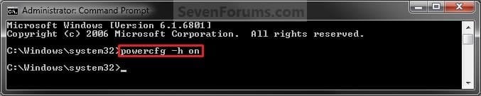

3. To Enable Hibernate
NOTE: This step will restore the hiberfil.sys file, and the Allow hybrid sleep and Hibernate after Power Options under Sleep.
A) In the elevated command prompt, copy and paste the command below, and press Enter. (see screenshot below)
powercfg -h on
C) If you would also like to have hibernate turned on, then you will also need do to step 2 in OPTION FOUR below.
D) If you like, you may also wish to add or remove Hibernate from power menus.
E) Go to step 5 below.
4. To Disable Hibernate
NOTE: This step will disable hibernation, delete the hiberfil.sys file, and remove the Allow hybrid sleep and Hibernate after Power Options under Sleep. This will also disable fast startup in Windows 8.
A)In the elevated command prompt, copy and paste the command below, and press Enter. (see screenshot below)
powercfg -h off
B) Check your Power Options to make sure that the Critical battery action and Low battery action settings under Battery are not set to Hibernate, and go to step 5 below. (see screenshot below)

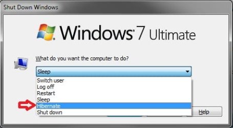

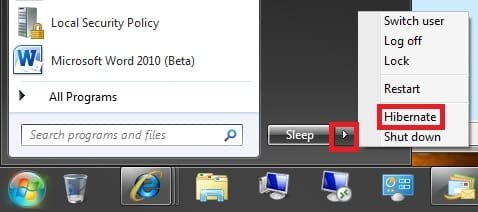

I want hibernate as an option on the Shutdown menu on a desktop. I ran the enable command and still don't see it. Is hibernate even an option for desktops or is it only available on laptops? I thought it could be enabled via registry change. (After only a few days I love Win7, so glad I skipped Vista!)
Hello Joeb, and welcome to Seven Forums.
You should have Hibernate in your Start Menu arrow menu here:
...and when you press ALT+F4 after clicking on the desktop.
You might also find this hibernate shortcut useful. You can pin or use it anywhere it Windows 7.
