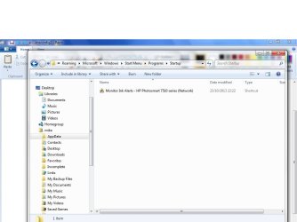

I recently developed a virus on my computer. I did a MSCONFIG and found the malicious file in the start-up and ‘Disabled’ it so it did not run when I started my computer. Next, I wanted to delete this file so found its location in C:\Users\Appdata\...etc. However, when I got to the final folder there was no file visible? I have turned on all hidden files in explorer but still nothing there? Do I need to ‘Enable’ this file to start-up before it appears? Any help would be very much appreciated.

Thanks for the replies.
Sanddeepp I have tried both them specs but unfortunately none have removed the infected file.
Cottonball I have located the file but it does not appear in location specified in MSCONFIG for me to delete it.
I have attached some pics to try and explain.
The first is showing the name of the file that I have disabled
The second show the path to its location.
The third shows the location folder but no file in there.
Hope this explains a bit further.
Thanks in advance.

Please press on with Post #3.
The tool may shed some light as to where that file is.
It looks to be written in a foreign language, maybe Russian, but not sure.
