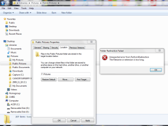

Hello All,
Please excuse my lack of Computer terminology - I have very little knowledge in Computing as I only use my Computer for browsing the Internet, Emailing and online Shopping so I would need `Idiot Proof` Step by Step Instructions to carry out any suggestions to help me with this problem Please:

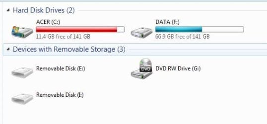

Because I have very little Free Space on my Computer`s C Drive and the Free space keeps dropping down inexplicably by approximately 10 - 12 GB`s every couple of days causing the Computer to be completely unusable I wanted to move some Library Folders from the C Drive to the F Drive which has loads of Free space and I tried doing that following Instructions that I found on the Forum here:
User Folders - Change Default Location
Unfortunately when I tried to move the Folder - Pictures [also happened with Videos] - I received an onscreen Error message which stated:
`Unexpected error from PerformRedirection The file name or extension is too long`
I am attaching a Screenshot of that Error message.

Having read some of the information on the other website I am guessing that the Error message is referring to a `hidden file name` because my Computers / Library `Pictures` is obviously not a file name or extension that is too long and my attempted new Location which was F:\Pictures is also obviously not a file name or extension that is too long ?
I think that I remember a comment referring to `Finding the File name / Extension and making it shorter` - something to that effect - but as I mentioned the details were FAR too complicated for me to even try to understand.
Unless I can get the process explained in very simple `Step by Step instructions`I would not be comfortable trying to Rename Folders / File names / shorten File names / Extensions in case that meant that they just disappeared because I had made a mistake.

I am attaching a Screenshot example of the C Drive having dropped down from approximately 20 GB`s to about 11 GB`s.
Most of the 66.9 GB`s that are showing on the F Drive are Pictures & Videos Folders contents that I previously Copied & Pasted to the F Drive before I found the Forum thread Instructions - that was an Error on my part because I found out afterwards that doing that would not have caused Windows to put future Files to those locations as the Default location.
I have not deleted those Folders yet in case something goes wrong and I accidentally lose Data / Folders / Files while trying to move them correctly.
Before I Copied & Pasted those Folders into the Computer`s F Drive there was approximately 135 GB`s of Free space there out of the original 141 GB`s.
I am desperate to get help with gaining a large amount of Free space on the C Drive by moving the Library Pictures and Videos Folders to the F Drive by somehow overcoming the cause of the Error message.

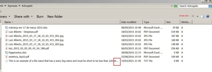

Windows has a 260 path character size limit.
Before Windows 95, Windows only allowed file names that were eight characters long, with a three character file extension–commonly known as an 8.3 filename. Windows 95 abandoned that to allow long file names, but still limited the maximum path length (which includes the full folder path and the file name) to 260 characters. That limit has been in place ever since. If you’ve ever run into this limit, most likely it was when you were trying to copy deep folder structures into other folders, such as when copying the contents of a hard drive to a folder on another drive.
If you have a file name that has 220 characters (space included) and you try to move to a F:\My pictures\Summer 1998 trip\Scotland and Ireland\Whisky distillers\ the folder path is 72 Characters will fail (220+72=292 > 260)
You have to find a file that has a huge name and make it shorter
If you have a file name that has 220 characters (space included) and you try to move to a D:\My pictures\Summer 1998 trip\Scotland and Ireland\Whisky distillers\ the folder path is 72 Characters will fail (220+72=292 > 260)

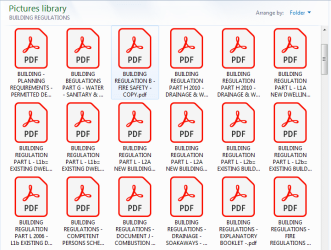

Hello again,
Thank You very much for your explanation - however now I am further confused about what Picture / File name could have caused the Error because although I stated that I would have named a lot of the Pictures / Files with a long descriptive name I would not have used anywhere near the amount of characters that You described for any individual Picture or Folder re. the 260 character limits.
Something that has now occurred to me is that within the Computer`s Public Pictures Folder are many Sub Folders that I have created which have many Pictures / Files within them - every one of those Pictures / Files have long descriptive names.
So for example there is a Folder within the Public Pictures Folder which is Named `BUILDING REGULATIONS` and within that Folder there are 121 PDF`s which all have long descriptive names.
I am attaching a Screenshot of just a small section of the `BUILDING REGULATIONS` Folder contents - the individual Pictures / Files names are much longer than what you can see on the Screenshot - probably at least twice as many characters as you can see for each file name.
I am now fairly sure that the majority of the Pictures / Files in my Computer`s Public Pictures Folder are in Sub Folders and have long names.
Does that mean that the characters in the name `Public Pictures` Folder plus the characters in the names of the Sub Folders and ALL of the names of the Pictures / Files within that sub folder are adding up to many hundreds of characters in `File Names` and that is the cause of the Error / Error message that I got when I tried to move the Pictures Folder from the Computer`s C Drive to the F Drive ?
If that is the case I might as well give up now on trying to move the Pictures Folder to my Computer`s F Drive because there is no way that I could ever rectify the situation by having to Rename nearly EVERY Folder and EVERY Picture / File - 30,000 Pictures / Files.

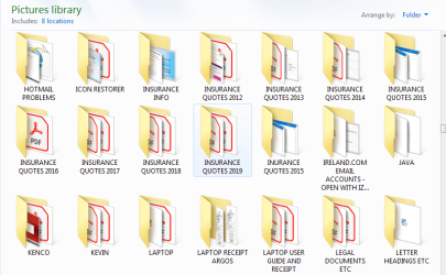

Thanks for your reply - however on my Computer the steps that you described produce a different display:
When I open Explorer and select View details for `Pictures` that does not open a list of Pictures / Files on my Computer it opens a display of the Sub Folders - see attached Screenshot.
Even if there was a method of displaying a List of all the Pictures / Files because there are almost 30,000 of them I could not go through that renaming probably many thousands and if there were `Names` that I had not created I would not know whether I could change the name / what could be removed without causing the Pictures / Files to be damaged / no longer able to be opened / lost.
Could You please give me instructions on how to gain Free space on my Computer`s C Drive by carrying out the other processes that you mentioned in your first reply to me - I would really appreciate it:

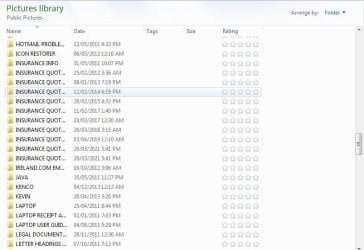

Hello again Megahertz07,
Sorry - my mistake but when I corrected it a List of the Public Pictures Sub Folders was displayed - see attached Screenshot.
The only way to see any details about those Sub Folders [not the contents] was to hover the Mouse curser over them to view hidden information - there seemed to be some information but it did not look like a `File names` and I could not get a Screenshot of any of that because moving the curser closed the information box.
The `PrintScreen` facility does not work on my Computer I have to use `Snipping Tool`.
Opening any of the Sub Folders would obviously display the contents / Pictures / Files.

Double click on each folder to see their files names. On the details view, adjust the column do see how big the files name are.

Double click on each folder to see their files names. On the details view, adjust the column do see how bib the files name are.
Hello again,

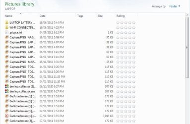

Double clicking onto a Sub Folder from the previous list display opens the Sub Folder and displays the contents / Pictures / Files - Screenshot attached.
Clicking onto some of those Files / Pictures would perhaps display further information but I cannot be doing this for all of the 30,000 Pictures / Files contained in the `Public Pictures` Folder.
Because of what I previously wrote about it being impossible for Me to ever be able to go through the approximately 30,000 Pictures / Files I will have to abandon trying to move the Computer`s Public Pictures Folder from the C Drive to the F Drive.
Finding and renaming probably thousands of Files / Pictures without missing even ONE I feel is completely beyond realistic and too daunting a task for Me and perhaps the same for any Domestic Computer user ?
Would carrying out the other processes that You described in your first reply to me create a few GB`s of Free space in my Computer`s C Drive ?
Perhaps even just a few more GB`s would make my Computer more stable and less likely to `Freeze Up` when the unexplained 10 -12 GB drops in Free space occur ?
I would really appreciate your help with Step by Step Instructions on how to carry out those processes please.
Thanks again for your help.

You almost did what I asked.
Why didn't you expand the Name column to see how big the files name are?
