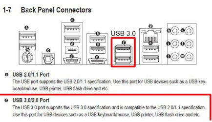

When I had that problem it was because the non-working USB ports were USB 3.0. The USB 2.0 ports worked just fine.
To see if that is your problem you will have to look at the motherboard's manual to see if any of the ports are USB 3.0
The following shows an example where some ports are USB 3.0 and the rest are USB 2.0:

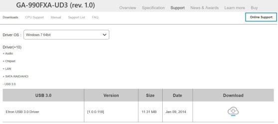

Windows 7 does not natively support USB 3.0. That means only USB 2.0 ports work after you install Windows 7. The solution is to go to the motherboard's website and downloaded the USB 3.0 driver for it. Installing the USB 3.0 driver should solve the problem.
The following shows the USB 3.0 driver I had to download for one of my motherboards.

USB3 ports have blue internal connections
The standard color for USB 3.0 ports is blue but that is not required. If you are not sure you have to check the manual.
