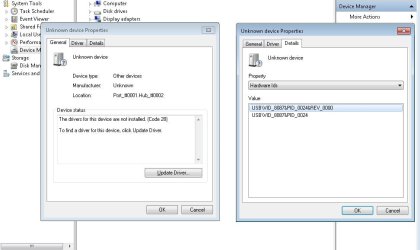

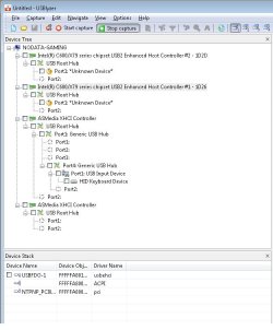

I have Windows 7 Ultimate x64, all of a sudden windows was not able to add any new USB devices. I went into device manager and removed some devices and then tried to scan for them. For the first little while it would add some back but not others. I tried to reboot into safe mode and found that a brand new keyboard that had never been used on that system would work in a USB 3.0 port only but no other ports worked. I then removed all USB devices to have it redetect them all... well there went the one keyboard that I had.
I booted off a livecd and into the bios and everything works just fine.
I booted into recovery mode and loaded the registry, I removed all devices from the ENUM/USB. I rebooted the computer and was able to login with the keyboard and mouse... Hurray... nope soon as windows started to load the drivers I lost all USB. I figure there is a corrupt driver in there somewhere.
The only way I am able to access the system is via RDP. I'm glad I left that on for some reason. I do not have windows recovery enabled so that is out of the question.
Here are a couple of pictures, please let me know if you guys have any thoughts.

When you removed your USB devices, did you select "Delete the driver software for this device" as well?

yes, I make sure that if I get the option to check the box I do.

It seems like no matter what I plug in, USB2 or USB3, that it's not actually comparing the vid/pid to what's already installed. I can clearly copy the vid/pid and past it into google and find the drivers. I have them all installed and also stored in a drivers folder but it won't find them when I point to that folder.

completed, no change on the usb driver front.
The USB controllers are showing up as "Universal Serial Bus (USB) Controller". I tried to install a freshly extracted version of the drivers but I get the same error, "The system cannot find the file specified".
