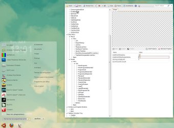

Hi
I am working on a windows 7 theme and have certain issues and doubts.If someone could give me some clues and insight in to how aero works would be really great
1.Drop shadow in Start menu
The image i made for start menu has a drop shadow of about 3 pixels which is not coming as it should be in windows style builder
I have done some research and the result is the image does not have any problem........it works fine in one of the themes called Mac 7
Mac 7 Theme
there has to be a setting that makes it work related to transparency in images or shadow fill etc
Here are the two images that show the difference

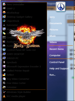

3.When i make a Semi transparent image for start menu this how it turns out to be in the theme.What is that dark color coming below the program list??

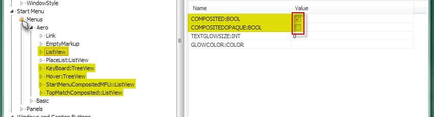

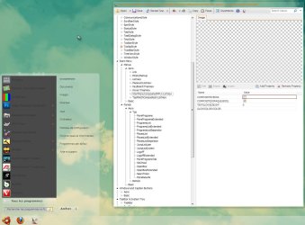

I'm not pro enough to tell you about the shadows (i only made 3 vs, so i'm still a novice...)
but i think i can help you about the start menu (i had the same issue).
By comparing with other visual styles i understood i had to set some parameters...
So, see my screenshot and do the same setting on the right column for each marked point on the left...
I'm not sure if they are all necessary, but it works for me like that...
I hope it will help you...
Note : if needed, i show you how to add the property...

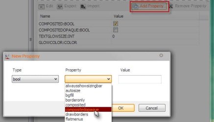

If i understood correctly I added composited:Bool property to all the properties shown in yellow on the left side.compositedopaque: bool was already there but check marke so I unchecked compositedopaque: bool and check marked composited:Bool
But it did not work and I also chcked the Mac7 theme where it works even without the composited:Bool property and the changes you mentioned
Am I missing something??
Damned, sorry... In my case it worked... but maybe i am missing something other...
I don't understand, look at these...
Yeah that works mate I thought it was a fix for the drop shadow
the black thing below the program list is gone now
Thanks alot mate!!

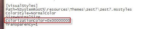

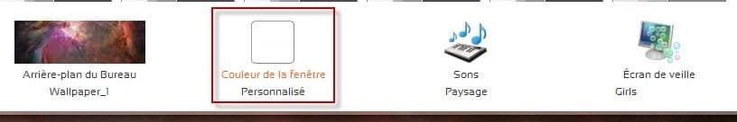

BTW i see you asked for the system colour... Do you mean the color of the windows in the personalization section (as shown)?
If this is it, you have to open your ".theme" file with Notepad and find the line shown in the attachment.
I can't tell you the colour codes, go & see in a file which have the colour you want to copy it...
"0x00000000" here is for "no colour" (totally white, which means in reality every colours, but this is not the debate...:sleepy:);
I hope this will help you...

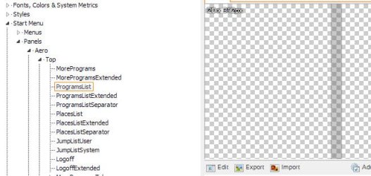

Can you define the steps used to get the left side of start menu to be semi-transparent? I've added a color to mine which did away with the bright white color but in trying what I think you are saying to do, it doesn't appear that way for me. Granted, I applied the theme after saving it to the desktop which never really implements all the changes correctly so that may have been the reason. Still better yet, details please.

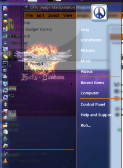

Left side transparent is the one I'm looking for. I added a color background to it way back yonder a long time ago. Instead of the default white, I made more of a white cream color. Yes, I know about adding it to resources/theme. Most of the time, I only add it there when I see that my edits have worked.

ColorFill option in WSB. Do I need to make it an image?

But first have a look in the properties, there's a "color/transparentcolor" but i don't know about this property.
My method is to edit the image in the panel section so i can set my transparency exactly as i wish
and apply the properties described above in the menu section...

Oops, sorry but it's a bit confused for me... :confused:
Could you please be just a little clearer cause i'm lost...
Where did you add color? To your theme? And the code i gave doesn't make the theme appear white...? Is that the issue?
And you would like the detailled way to make your left side of start menu transparent...
Is that right, two requests, so...
Edit : Maybe you can add some images of your problem... ;)
Edit 2 : One thing, according to me, is that you have to copy your theme file and folder in the windows/resources folder (C:\Windows\Resources\Themes)
cause it is the path ordered by the "xxxx.theme" file, see the second line in the pic 2 of post #7...
Logically it could'nt work properly if you apply it from the desktop... But maybe i'm wrong...
Thanks
You need to give your images some transparency at
Start Menu > Panels > Aero > Top > ProgramsList
Start Menu > Panels > Aero > Top > ProgramsListExtended
just did what scoopeeedoo said to do
hope this helps
Jerry
