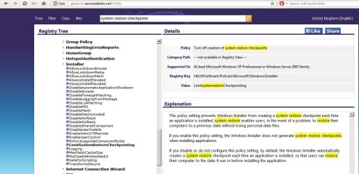

More Digging:
Group Policy Search for appropriate registry setting to adjust states that no registry settings are available:
However I subsequently found this. You could try it (create a system restore point first :) )
https://msdn.microsoft.com/en-us/library/aa369758(v=vs.85).aspx
Set value to 1 and see what happens. It probably won't have any effect in Windows 7 but you never know until you try it. If the setting is going to stick - test only after a reboot.
