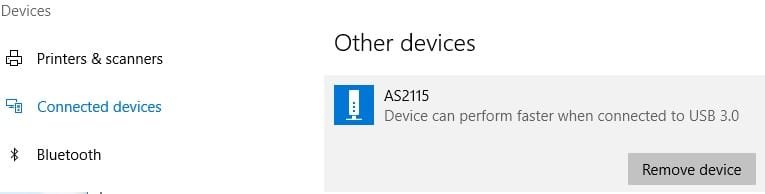

Hello everybody,
I have an Issue with the HDD. I wanted to plug in internal HDD as external via USB adapter. The windows 10 shows the driver in device manager and in computer management, nonetheless it is 'unkown' and 'not initialized'. In my computer it is not shown as well. I tried to plug it as internal and the windows booted 1 time, but after few tries to plug it as external via USB, trying to plug it as internal and boot is not done, because 'no operating system was found'. I have important files in the disk and it would be very good to recover them. I tried TestDisk which did not find the device at all, I tried to find it via Puppy Linux, tried partition wizard, which did not find any partition in the HDD, and tried MIni tool Power Data Recovery, nothing helped me. Do you have any Ideas how to recover the data from the HDD and make it later usable as external HDD via USB port?

It can be the USB port USB enclosure or cable fault. Install internally go to BIOS does it see it if it doesn't it's dear if it does make sure you boot from normal drive see if disk Management sees it then
