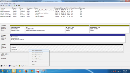

i have 2 external HDD each one of 300GB i wanted to merge them into one partition equivalent to approx 500GB(not less). i am using win7 and when attempt to do it with diskmgmt.msc tool:
Drive A = 300GB NTFS format
Drive B = 300 GB raw format (since already deleted volume)
when choose extend volume option for drive A and choose unallocated volume (drive B) got an error object is missing cant perform function
when try to create span volume got similar error.
any suggestions?
Windows 7 32bit
Windows 7 32bit

Main diskmgt.msc screen shot
attachment.php

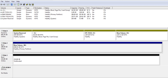

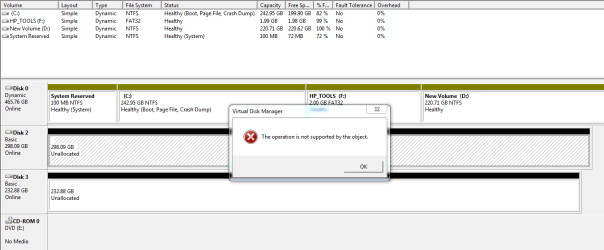

when i del both volumes (raw format) of ExtHDD and try to create a span vol from either of one got below error:
attachment.php
when one volume in raw format and other in NTFS, tried to extend NTFS vol and selected raw got below error:
attachment.php
not getting any option when selected raw vol:
attachment.php

Why is all of Disk 0 Dynamic? That shouldn't be like that.

It looks like you actually converted DISK0 to Dynamic which is only meant to span a single partition across multiple HD's. You'll need to convert it back before Win7 stops booting. Back up your files first, Use Option 1 here to avoid having to wipe out your Win7 install: Convert a Dynamic Disk to a Basic Disk
After conversion I'd also convert D to a Logical data partition so you can add as many adjacent Logical partitions as you want: How to set partition as Primary or Logical with Partition Wizard
As to the externals, I don't think a spanned volume can or should be on removable drives because they are less stable than internal drives, hence you would be risking your data in case one would die or have its file system messed up. If you need a huge storage partition for video files, etc, then look into a larger internal HD for more stablity.

I USED to SPAN HDD's - but be careful especially with EXTERNAL HDD's as now you need ALWAYS to have ALL the HDD's in the spanned group connected and they HAVE to be dynamic disks. Beware also that any error and you lose data in the entire spanned group.
A better solution might be to use Libraries.
I've solved this particular issue by actually using Linux as you can "mount" these into a single "mount" directory or create soft symbolic links.
Windows spanning works fine but be aware of consequences - I wouldn't recommend it for EXTERNAL drives - but fine for INTERNAL ones. Wit a Spanned volume set it's EVEN MORE IMPORTANT to take regular backups of your data or you'll be regretting say the loss of your "6.7 TB Multi media file" with 100's of your ripped CD's / DVD's / iTunes etc all down the toilet !!!!.
Your spanned drives should look like this when working. - For example spanned two volumes -- it will show two F drives but properties will list a single "composite F drive" with the total space aggregated.
Windows explorer now treats the F drive to a single aggregated drive.
(I think for spanning you also need to make them GPT drives) - can't remember as I don't use this method any more.
Finally DO NOT BOOT from a spanned volume it won't work !!! - If you've got a small HDD (or better an SSD) use that for the OS partition. Also I have to disagree with Greg above -- Logical Partitions are a MEGA PAIN and in any case you don't need them with GPT drives.
