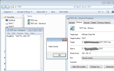

Create a regular shortcut for the file first (which has a little arrow on the bottom left of the icon) then on it make Right mouse click - Properties - Shortcut tab - click on the line Shortcut key - Press desired key combination - Apply.
(Limited to Ctrl+Alt+ one more key)

Thanks but I already tried that. It looks like you can not run a .vbs script using a keyboard shortcut after creating a shortcut , as in your post:-(
Nothing happens when you try the keyboard shortcut.
Obviously keyboard shortcuts work just fine with actual .exe programs , but do not work with a .vbs script. Thanks anyway.

Thanks, I tried your vbs and all works fine for me too using a keyboard shortcut.
My problem must be something to do with the script itself. I found it on a website when I asked about how to hide and unhide files and folders in W7 without having to go through the usual process.
I am not experienced with scripts but that script works fine, just that I can not get it to work with a keyboard shortcut that I put on the shortcut to the script.

I have copied and pasted your script. And key shortcut of it's shortcut worked for me.
The only problem I have found is that F5 command at the end of the script does not work, because Explorer window becomes inactive, when script starts.
I had to manually press F5. Other than that, is all works just fine:
script alternates settings for hidden folders.
