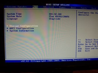

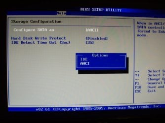

I removed the Seagate and I put 2 WD Velociraptors 300 GB each and 10,000 RPM, I have a concern, one it is on the port 1 and the other velociraptor is on port 3.
Does it affect in order to make appear the RAID option in the bios? Because it does not appear, it just appears these options: IDE and AHCI. How come it does not appear RAID in the bios options? What am I doing wrong? Or what do I have to do in order to setup in the bios as RAID?
I don’t know if this link below it is exactly my motherboard, it seems that my desktop came a little bit different than this motherboard or they designed specially just for best buy, I am not sure about it.
http://usa.asus.com/product.aspx?P_ID=6i86Hj0lGriFHfY9

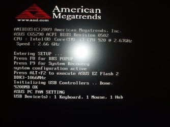

I took several pictures to show you what appears when I turn on the computer and when press <Del> to enter in the bios and when I just turn on the computer and I don’t do anything.
I went to Asus website and I downloaded the manual for Rampage II Gene Motherboard, I was reading it and It says that Intel Matrix Storage Manager option Rom utility will appear when I press CTRL + I , I tried it several times and nothing happens, is that option working in my Asus Desktop CG5290-BP007 ?
Please help me what to do, I would like to install Windows 7, my hard disks are not formatted I think so, because I just installed them and I am not able to see RAID in the bios options, Please tell what steps to follow in order to setup RAID 0 in this computer.

Rayo,
It looks like there are two SATA controllers in the MB. The one which you are selecting as AHCI, and to which your drives are currently connected, is the Intel controller which apparently does not have RAID capabilities. The JMicron controller does have RAID but the drives are not connected to it. You need to move your drives to the JMicron SATA connectors in the motherboard.
Note that this will require for you to load the JMicron driver before Windows can be installed.
Edit: Also note you will need to set the RAID disk you set up in the JMicron controller as the boot drive in the BIOS boot options, after the DVD/CD ROM drive.

BIOS Update
If you also go to support for your model, there is a BIOS Update available. It is under the files for the CG5290.

Raid On Rampage II
Your board supports Raid configs. Go to Asus and go to support and search for Rampage II Gene. It will list the latest ver files for you to download. The latest Bios was 0904. But I would check all of the available files to make sure you are up to date and ready for Win 7.
The above shows your internal Sata ports available on your board. It is from the manual which you can download.
This is a shot of your bios screen where you set the controller in raid mode.
You will need: Under the downloads You will find Sata --- Intel Matrix Storage Manager Driver V8.9.0.1023 Downlad this file and follow the instructions to make a floppy/USB stick for when you are loading Win 7
You Should get an F6 option during the load to load 3rd party drivers.
Down load from Others -- JMicron JMB36X Controller Driver V1.17.48.16 and do the same as for the Matrix Storage Manager.
But first load your new bios and set your controller to raid. On your first boot do a "Ctrl + I" and create your raid array. Now your ready to load Win 7.

Latest BIOS 0701
The latest board BIOS is 0701. Make sure you search for the BIOS for the CG-5290 (your model) and not the Rampage II Gene. If you try to install the BIOS for Rampage II Gene, it will NOT work. You must specifically search for the BIOS update by your Model, the CG-5290.

Asus cg5290
Hey, I also bought the same system from Best buy. I opened my case and saw the motherboard and looked it on line with the ASUS RAMPAGE Gene II. I found out that the motherboard they showed on the website is different form ours. The difference is that the ASUS websire shows a lot of other option like that are mounted on the motherboard that is not mounted on ours. Things memory ok, extra sate plugs, usb plugs and other little things. I also contacted the asus support and they said the version we recieved in our desktop does not support Raid. Though i did a search and found that people that bought our setup were able to flash the bios with a certian bios was able to setup raid. If you search "Raid CG 5290" you could probably find something.
