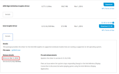

Thanks for the information.
Where did you get the drivers for the video cards? And which ones are you installing first? I believe that the correct order is Intel first, reboot, then the ATI card drivers.
You should have obtained the drivers from here (if you didn't):
HP Software and Driver Downloads for HP Printers, Laptops, Desktops and More | HP® Customer Support
The drivers are new as of March 1st of this year, so they should be fully up to date.
I let Windows find and install the correct drivers. I don't know the order they installed. After doing some playing I have determined if I disable the Intel graphics then I do get a desktop in normal mode,
