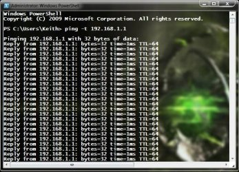

C:\Windows\system32>ping 192.168.0.1 -n 100
Pinging 192.168.0.1 with 32 bytes of data:
Reply from 192.168.0.1: bytes=32 time<1ms TTL=64
Reply from 192.168.0.1: bytes=32 time=1ms TTL=64
Reply from 192.168.0.1: bytes=32 time=3ms TTL=64
Ping statistics for 192.168.0.1:
Packets: Sent = 18, Received = 18, Lost = 0 (0% loss),
Approximate round trip times in milli-seconds:
Minimum = 0ms, Maximum = 3ms, Average = 0ms
Control-C
^C

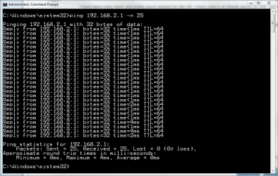

Simply not true. If I have a problem, I would not even think to state 'Because I have a problem, it's confirmed we all have a problem!'.
Kari

Everything is good here.
