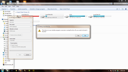

Hello I'm unable to format my D drive.
I've my windows in drive C and its full. Is this the reason I'm unable to format?
The errors are shown in the images..please help.. I want to extend memory of C: after formatting the D drive.
There were software's and games stored in this D drive, which I've moved them to F drive.

now I have 2 questions.

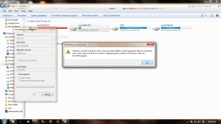

#1: how to get rid of the errors am receiving while "Quick formatting" the drive --as shown in the image that-- "windows cannot format the disk as it is being used by another program...."
#2. As my C: drive completely full, how can I extend it so that the memory is increased in it. If I cant be able to extend, what are the other ways to free the memory.
please understand, I cant uninstall the programs in Drive C because, all these are very important as they are very very use full for my project.
My PC has large volumes of useful information related to my projects.
Please provide me help in such a way that all these data is safe and my drive D is formatted along with freeing up the memory in Drive C:
Thanxx a lot for your help.

I'm assuming that C and D both exist on the same physical hard disk. In which case just go and get Easus Parition Master, delete the D partition, which will turn it into unallocated space, then extend the size of the C drive to take up all of the space of both C and D.
It's usually wise to make a backup to another drive before messing with partititions.
Intel Core I7
Gigabyte EX58-UD3R
OCZ3P1333LV6GK
Gigabyte - GV-N220OC-1GI
Antec Sonata III
You might want to move your page file to C: or another drive other than D:.
I don't think Disk Management will play nice as long as the OS is using D:
As activoice suggested, best to backup before modifying partitions.

I think using a Partition Wizard boot disk is safer when modifying partitions since the OS is not involved in the operations. And there are more options in the newest version, but I always keep the old 4.2 handy.

Hello team,
thanks a lot for your immense help. According to your suggestions, I've successfully extended the Memory on my C: drive.
Its good to see that there's no red color indication my C: drive any more...
Well done guys!! and more over, I've also set the drive D: for the virtual memory...thnxx a lot.
