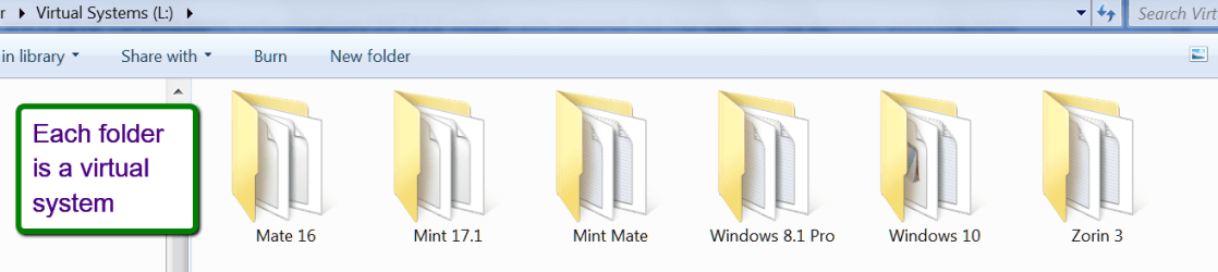

With a second 240 gig HD, no operating system, will a VM install and run? :confused: Thanks!

What you can do is to have e.g. VMware Player installed with the OS but then put the virtual systems on the other disk. Each virtual system is just a folder. I run 6 virtual systems that way from an external SSD. Here is a tutorial on how to install and operate those systems.

Thank you! I had chores to do today but now i'm back on the project. I think i got it just like you said, installed VM on my c:drive and made VM folders on my external SSD.

As to your original question, absolutely. My main drive is an ssd so I don't want to use up it's limited space with VMs so I have all my VMs on a secondary drive (hdd) with lots more space.
You can use an external as WHS suggests but you will take somewhat of a performance hit which may or may not be acceptable to you.

If you use a SSD on USB3 or eSata, the performance hit is negligible.

Last night i did move my external ssd to an internal hd with a sata 6 connection. I was concerned about the very thing you mentioned.
I'm trying to save space on my c:drive. Adding folders to my P: hd is going to solve my storage problem.
