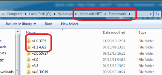

Just for kicks, I looked at my Windows .NET folders v1 and v1.1 only show up in the (x86) folder.

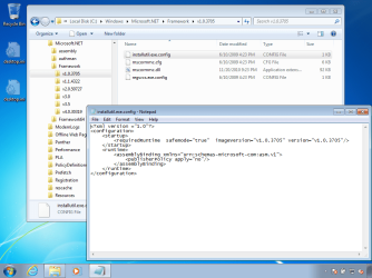

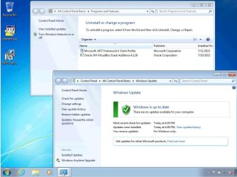

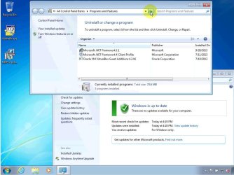

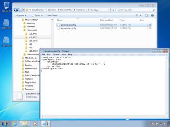

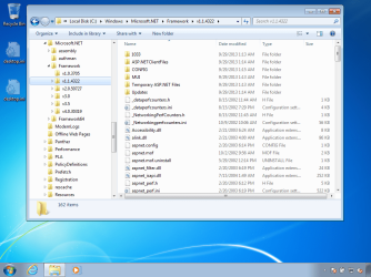

Those .NET folders don't have much in them until 1.1 is installed:
Before
Before
After
After

Based on the evidence before us, let me restate, with egg on my face :cry:, that .NET 1.1, once installed, will show up in the Pgm & Feats list, of this I have no doubt. ;)

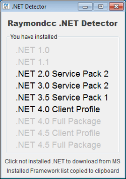

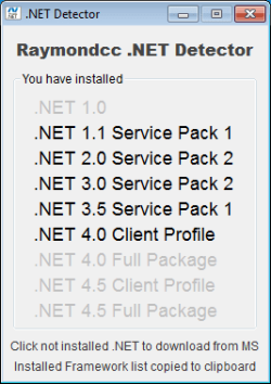

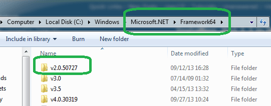

It's interesting that although versions from 2 to 4 are detected on my system, only 4 shows in installed programs.
http://www.sevenforums.com/software/149137-dot-net-4-problem.html#post1286949
