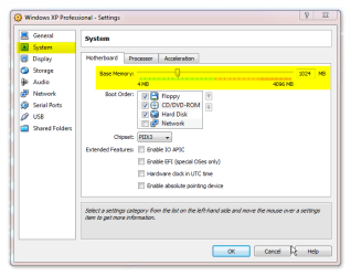

First, the amount of RAM. You can assign as much as you want to. Maximum is about half a gig less than the amount of RAM on your host:

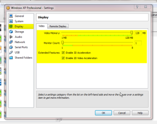

A virtual machine can not use GPU and audio card of your host; instead, it uses emulated hardware. GPU setting lets you to choose how much video RAM is used, my recommendation is to use the maximum 128 MB. Also, with Windows guest machines it is recommended you enable both 3D and 2D acceleration:

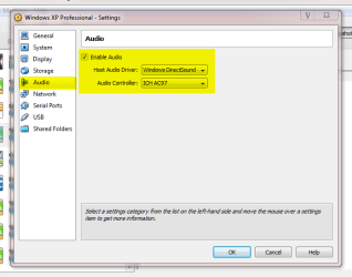

Here you have a very limited choice of audio devices you can use:

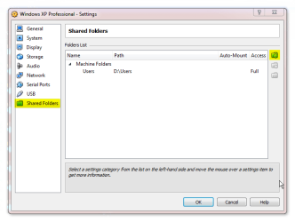

From Shared Folders you can select all host folders you want to have available in guest. Click the small folder symbol at right to add folders:

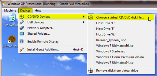

When XP guest is running, you can add any of host's CD/DVD drives or any ISO-file to be used as guest machine's D: drive:

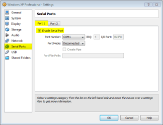

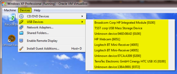

USB menu let's you choose which host USB devices should be attached to guest:

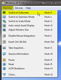

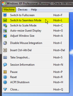

The VirtualBox menu bar disappears when full screen or seamless mode. To show VirtualBox menus, move the pointer over the lower edge of the taskbar (in the middle of taskbar):

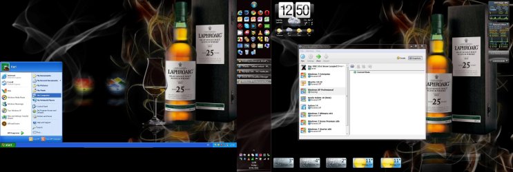

Seamless mode is something I like and use very much. It integrates the guest completely to host desktop, making its display transparent, shared with the host. Here's an example, my desktop just moments ago. Main display on the right showing normal Seven desktop, left display running XP guest in seamless mode:

That 3D & 2D issue sounds weird. Those settings are about the first ones I enable for every Windows vm.
Have you tried to add the modem to guest vm from USB menu? If host does not recognize it, it is one of the unknown devices listed. You could also try to add it through com ports settings.

Thanks Kari ^ I just tried out seamless mode and its great - I really like. I have been using VirtualBox for about 6 months with a hackintosh guest in Win7, and just yesterday installed another machine for XP Pro because of all kinds of trouble with Virtual PC access rights for XP Mode;... but now this seamless mode is very cool!

The seamless mode really is something. especially if you have two or more displays. It's a shame you can not use it with Mac guests because of lack of Guest Additions.

Ok, so I enabled 3D graphix accelerator and the guest started up, no crashes no problems. I still have 2D video disabled.
I did try to add the usb edge modem to guest, that worked. The driver install is self extracting and prompted me to install. It worked to a point where the driver had to install on host also, which stopped because of incompatibility. I'll try it by enabling COM port in menu. Do I connect the edge modem then to the rear usb I/O op the pc? Till now, I connected the usb edge modem to the front usb I/O.

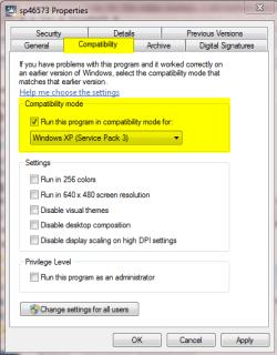

Have you tried to install the modem to host using compatibility settings? Copy the installer to desktop, right click and choose Properties, then change compatibility as XP. Install the modem to host. Then run the XP vm, attach the modem to it and try to reinstall.

I tried the compatibility settings, but haven't had any luck so far. I'll double check it just to make sure. I'll keep you posted. Its been a few days, haven't been online. I still need to figure this out, so I'll keep you posted.
