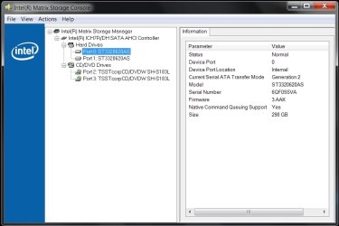

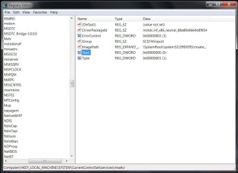

Hi Kari & Welcome to the Seven Forums! :)
Another member here (scaramonga) pointed me to this fix so I'm not taking credit for this...but here is the fix for this!!!
It's a registry value that has to be changed. Once changed it installs the drivers with no problems at all.
With this fix I now have AHIC set in the bios with NQC enabled! :p
AHIC (Advanced Host Controller Interface) enables native command queuing and hot-plugging through SATA host controllers (Serial-ATA) for your hard drives. In many scenarios it enables more efficient multi-tasking. Vista was the first Windows OS to support AHCI out of the box, where as Windows 7 does the same. But an issue with AHCI is that if you install the OS without enabling AHCI in the BIOS, enabling it after installation will render your OS unusable. This is because Windows disable the AHCI driver since it is not needed during the installation.
There is one way to fix this, although you need to have knowledge of registry editing. The detailed steps from Microsoft are as follows:
To resolve this issue, enable the AHCI driver in the registry before you change the SATA mode of the boot drive. To do this, follow these steps:
  1. Exit all Windows-based programs.
  2. Click Start, type regedit in the Start Search box, and then press ENTER.
  3. If you receive the User Account Control dialog box, click Continue.
  4. Locate and then click the following registry subkey:
HKEY_LOCAL_MACHINE\System\CurrentControlSet\Services\Msahci
  1. In the right pane, right-click Start in the Name column, and then click Modify.
  2. In the Value data box, type 0, and then click OK.
  3. On the File menu, click Exit to close Registry Editor.
After this you’ll have to restart your computer, go to BIOS and enable AHCI. When you log in to Windows again, you’ll notice the installation of drivers for AHCI. Another restart will be required to finish the driver installation.
After it does all this, you can then update the drivers to the newest available as I did shown in the screenshots below... ;)
Hope this helps you Kari!

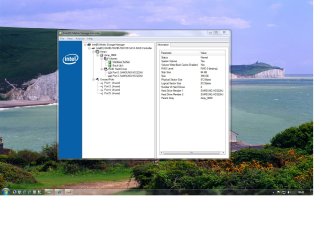

Sorry if I bump the thread but I've got problem with the Matrix Storage Manager.
I followed the suggestion to change in regedit and made it AHCI in bios. I booted fine and tried to install the program and it still says I dont meet the minimum requirements.
Windows 7 RC r.7100 64bit
