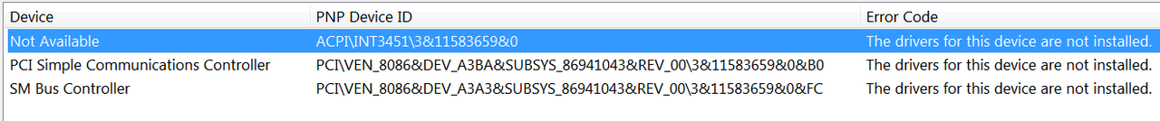

Try adding your id's like this poster did
You can find the id by msinfo32.exe >components >problem devices

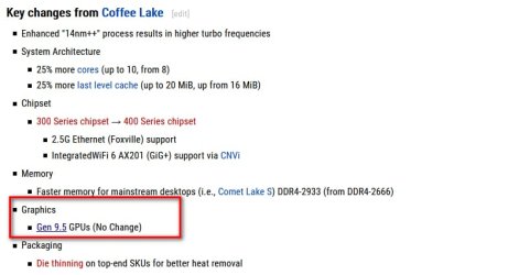

Intel® Core™ i7-10700 Comet Lake is 10gen.

In "msinfo32.exe >components >problem devices" I see:
I've added the following (last) line to igdkmd64.inf:
I've selected igdkmd64.inf in the Device Manager, and got the following error:
(This driver does not support your version of Windows).
Thanks again. I appreciate your help.

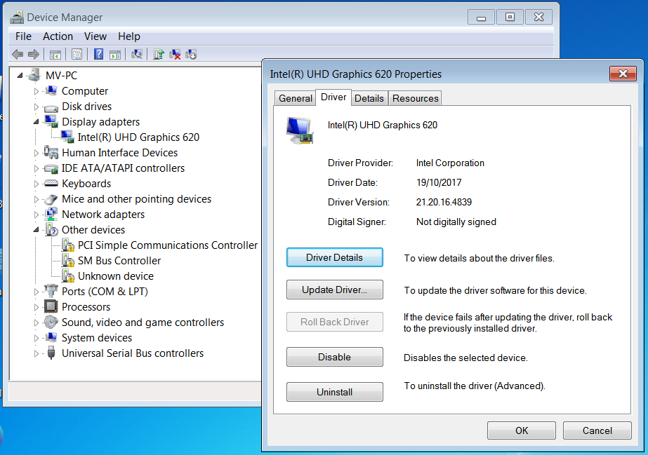

Rebooting after adding
%iKBLULTGT2R%    = iSKLD_w7, PCI\VEN_8086&DEV_[B]A3A1[/B]
, UHD 620 (NOT 630) seems to have been installed successfully.
And I have one less item in msinfo32.exe >components >problem devices.
But I do not get the Aero effects, the performance is poor and I assume that hardware acceleration is not working.
Uninstalling and reinstalling with either DEV_9BC5 or 9BC8, Windows disables the driver (code 43).
Any idea?
I really need it to work. :)
I'd appreciate it.
