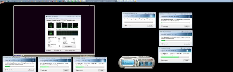

Another screen was made earlier while transferrring a large volume of files between different drives for temp storage while the tuner card was also in use during a live composite feed with a look at the performance monitor. You see less tasking on the cpu activity will all that going on then with the previous image posted.
