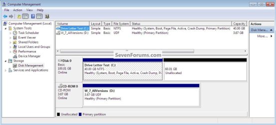

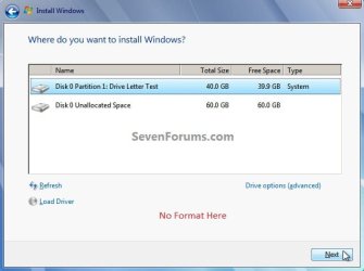

Though I didn't think it would work, I wanted to have a go for my own experience so here are the results; it did not work.
In diskpart I did a clean all just to have a fresh start, then I created the partition.
click to enlarge
Then during the install, I did not do a format here.
Here's the end result.
