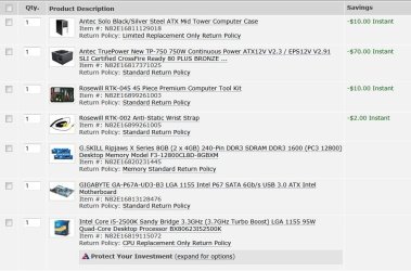

Updated:
· Intel Core i5-2500K Sandy Bridge 3.3GHz
· Gigabyte GA-P67A-UD3-B3
· G-Skill RipJawsX 8Gb (2x4Gb) 240-Pin DDR3 1600 Cas Latency:8
· Antec Sonata Elite Black Case
· Antec TruePower Supply TP-650 650W

OK, almost ready! I've attached my order in from New Egg but have pushed the button yet. I'd like to get some final thoughts. As ignatzatsonic pointed out, there's some good deals going on until 4/7/2011. I could sub a 650w PSU & save $20. Also, Corsair RAM is on sale & would save $25. Both are listed @ Gigabyte's site for tested RAM http://download.gigabyte.us/FileList/Memory/mb_memory_ga-p67a-ud3-b3.pdf , at least G.Skills is but a lesser Gb version of Corsair's is listed which I would assume is the same.
Also, Commodore Pet made a suggestion to channel savings into an SSD drive. This would go good with silent PC goal in mind. The question is can I do this with an Win 7 upgrade disc as I have posted these concerns before http://www.sevenforums.com/hardware-devices/149106-pc-refresh-possible.html . I think the answer is yes because HDDs & other hardware do go bad & there is a need to transfer product keys. My current C: is 75Gb so I wouldn't need a large one; 80-120Gb. SSDs of that size range $100-200.
I'll order on 4/4 or 4/5 so please post your final thoughts. Thanks.

Looks pretty good.
I'd definitely downgrade to the $70 TP-650 power supply. Even that will be overkill, but it's a great price.
The toolkit is an OK idea, but all you really need is a small Phillips head screwdriver.
I'd order a set of thumbscrews for the case if the Solo doesn't already employ them. Makes it much quicker and easier to get inside the case.
You might order some Arctic Silver 5. The CPU will include one batch of thermal paste, but you would need more if you ever had to remount or change the heatsink.
It appears you are going with the stock Intel heatsink to start with. That's fine as long as you understand you may not like its noise profile and you will have to upgrade if you do more than mild overclocking.
The wrist strap is a good idea. As I understand it, static discharges have a cumulative negative effect, even if they are so small as to not be felt.
Go to Gigabyte and get all the downloads.
You won't have any issues with an SSD if you choose to go that route.

Both 750 & 650 are that way? What PSU would you recommend?
