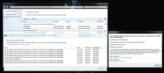

The following update keeps getting installed:
"Security Update for Microsoft .NET Framework 4.6.1 on Windows 7 and Windows Server 2008 R2 for x64 (KB3136000)" here is further information about how I have tried to resolve the problem:
  • The update says it was installed successfully
  • Downloaded and installed SURT
  • Deleted the C:\Windows\SoftwareDistribution folder so it got recreated again.
  • Windows Resource Protection did not find any integrity violations.
  • Have uninstalled it and then downloaded and installed it directly from:
    https://www.microsoft.com/en-us/download/details.aspx?id=51423
  • The compressed CBS folder is 150MB but I have attached the WindowsUpdate.log file if it helps.
Windows 7 64bit

Thanks but the installation processes doesn't fail and I am able to to connect to:
403 - Forbidden: Access is denied. (Link to URL automatically gets displayed as 403 on this forum)
Which redirects me to:
http://arrcache.download.windowsupd...RR-CSHOST=arrcache.download.windowsupdate.com
I can also download cab files from that same folder:
http://ctldl.windowsupdate.com/msdownload/update/v3/static/trustedr/en/disallowedcertstl.cab
http://ctldl.windowsupdate.com/msdownload/update/v3/static/trustedr/en/authrootstl.cab
As provided here:
https://support.microsoft.com/en-us/kb/2677070
I even reinstalled the update with my firewall and antivirus disabled which had no affect.
please turn off the update driver option, its having a prob with one.
might correct the problem.
Carried out the instructions here if that's what you meant:
https://support.microsoft.com/en-us/kb/2500967
Unfortunately that change didn't help.
When you deleted the folder did you stop windowsupdates service if not that would create more issues.
Yes I stopped the service before I deleted the folder.
The best I can do at the moment is to hide the update but I would like to try and get to the bottom of it.
