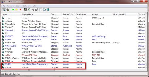

Next we'll check driver states. Download Serviwin. Unzip the file. Right click Serviwin.exe and run as admin
Click View->Drivers. Scroll down to see WudfPf and WUDFRd
  • WudfPf status should be Started
  • If WUDFRd status is also Started, then all's OK. The driver was started on retry
If WUDFRd status is Stopped (as the case in my snapshot below), right click, set Startup type to Automatic. Reboot.
