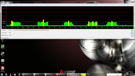

Often lagging/latency is caused by a bad driver please download this free latency check and run it. DPC Latency Checker
let us know the results

Well, I did as you told. I installed the software, and ran Half Life 2: Episode 1 on full graphics. Attachment One, is s what I got.

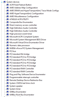

According to the DPC Latency site, I then also tried to disable the drivers and play the game. I disabled a lot of non-essential drives, audio drivers, etc. but to no avail. I left the "system devices" part alone, as there were too many drivers to disable and constantly disabling those other drivers and re-starting the game really tested my patience, lol!
Hope I did good...
