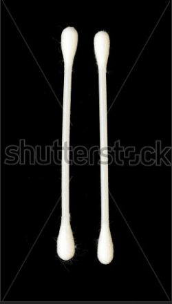

Yes as pbcopter says mate and I find that you can feel for any movement by gently rocking the fan from side to side. For lubrication I use WD40 or any one of those very light penetrating oils - the ones you can use for loosening rusty nuts or dispersing moisture on car electrics.
Now to do that just spray some into a small container and dip a cotton bud (see pic) into it and apply that way it will not then flood the whole thing. Once free I usually do the same with some light sewing machine oil but sparingly.
