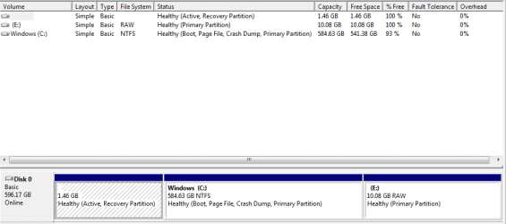

My Toshiba laptop suddenly was unable to boot to Windows 7 Home yesterday... the post was generating an error "No operating system."
So then I booted into Linux via a live CD. From there, I could mount my Windows C-drive and see documents still intact. However, using the app GParted to look at my hard drive, I noticed that sda3, the Toshiba Recovery Partition, was of "unknown file format."
Also, it was missing its usual label "HDD RECOVERY" and no space was used out of its 10.08GB (usually, 9.49GB is filled). Strangely, the boot flag was set to that partition (sda3) instead of its usual location on sda1, the System partition.
I used GParted to move the boot flag back to sda1, and after that, the laptop was able to boot to Win7 again. However, Disk Management showed that the recovery partition was of "RAW" file format with 0GB used.
Any clue on whether this was caused by a destructive trojan or MBR rootkit? Perhaps attempting to hide in the recovery partition? I just returned from a 1-week visit to my cousin's house, which has a "suspect" network... she had 40 trojans removed from her laptop a month before. I was getting a few script error messages while on the internet there.
Or was this related to hardware failure? FYI, I did have a poor shutdown from Linux live CD right before (CD was ejected too early, shutdown failed, and I had to force Power button down. But after that, I cleared the memory with an unplug and battery removal). Could that mess up the MBR/boot AND corrupt an entire partition? I doubt it, as Linux was booted off a CD into memory, not installed.
I can no longer use the non-existent recovery partition to reinstall Windows7 (and wouldn't trust the hard drive without a 0-fill wipe first, anyway), but thankfully, I made 3 recovery DVDs last year. I just need to run those, correct? Thanks.

It would help to have a drive map snap of Partition Wizard bootable CD. If Recovery is truly ruined and the Boot flag on the Linux boot disk means that the System Active flags were there, then you might be able to start Win7 by Marking 7 Partition Active to run Startup Repair - Run up to 3 Separate Times.

As mentioned in my post, I actually AM able to boot to Win7 again if I use GParted to move the boot flag back to sda1 (system) from sda3 (recovery), probably because the latter partition is, I suspect, corrupted. It shows as "RAW" or unknown file format and takes up 0 MB. Question is, what caused that... more likely the poor shutdown, or an MBR rootkit? If it's the latter, I can't trust the Recovery partition ever again, even if a boot flag or MBR is recoverable... agree?

It is common for some OEM machines to have the Recovery partition contain the boot files and be marked Actve so it can be booted in case Recovery is needed. Others use the F8 System Recovery Options to boot Recovery which is more volatile.
So it may be required that Recovery is marked Active to run, or it may no longer run. But you can always get the vastly superior Clean Reinstall - Factory OEM Windows 7 when you're ready to settle down with a perfect install of Win7 which we specialize in here.

What I do know is that my Toshiba laptop's boot flag used to be on sda1 (System partition). What I don't know is if an attempt to boot from Recovery is supposed to cause that boot flag to move from there to the sda3 Recovery partition. Actually, I should test it (will let you know). The alternative explanation would be the nefarious one (rootkit), I guess!?

If you have the System Reserved partition then it most likely had the System boot files and Active flag on it. The Active flag may have moved there once you tried to run Recovery, or during a repair attempt. It's not known viral activity.
Once you have any infection cleaned up and the System Files checked, I'd move the Active back to System partition and run Startup Repair up to 3 separate times until Win7 starts.
When you write "moved there," do you mean the System partition, or the Recovery partition?
My boot flag was originally on the System partition, but it apparently got moved somehow to the Recovery partition (which happened to be missing or corrupt, and thus the inability to boot on Saturday).
I moved the boot flag back to System yesterday, so that we could boot again, to run the TDSS and FRST scans. I can attempt a reboot back into Recovery tomorrow (by pressing 0 during startup), to test if the boot flag will get moved from that action.

The Boot flag means different things in different environments. In Disk Mgmt it means the partition currently booted. In Partition Wizard which we rely most heavily upon here it means where the System boot files reside - which is signified by the System flag in Disk Mgmt. I'm not sure what it means in the Linux app you used but likely System boot files reside there and it is booting the OS.
Active flag points which partition is to boot, and Recovery can be made to boot in some PC's by marking it Active. So the Active flag might have been moved there when you attempted to run Recovery.
To repair Win7 once it's disinfected (if so) and system files checked, we mark the partition intended to boot Win7 Active and run Startup Repair - Run up to 3 Separate Times
until Win7 starts and its boot partition holds the System flag meaning the System files are booting from there. It explains in the tutorial why it's run 3 times, and why this is the most comprehensive method to repair or rewrite the System boot files.
FYI, I tried booting from the Recovery partition again, and that still doesn't work. Nor did that action cause my boot flag to move from System to Recovery partition, which means that something else did.
In summary, my Toshiba laptop does boot right now, from System partition, because I had manually moved the boot flag back to it. TDSS and MWB scans were negative but run from regular (not safe) mode.
However, my Recovery partition is damaged/gone for whatever reason, and thus, I don't trust this hard drive anymore and feel compelled to run a 0-fill wipe and restore from my recovery DVDs (in order to re-install a clean OS).

Startup Repair will check for any problems and attempt to repair them if it finds any, so yes it is a good idea even if its booting.
I would not be too worried about being hijacked since there isn't any infection known to move the Active flag. Do you have other symptoms more related to performance which make you think you've been infected?
However if you are still running factory preinstalled Win7 that is a corrupt install to begin with, larded with smothering bloatware and useless duplicate utilities that have much better versions built into Win7. So I would unleash Win7's native performance by doing what most tech enthusiasts do to Clean Reinstall - Factory OEM Windows 7.
Everything you need is in the link to get and keep a perfect install, as long as you stick with the tools and methods given.
