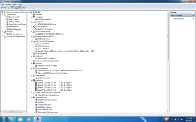

Hi there ... Which Version of Windows are you using ... Can you please Post a screen shot of the Device Manager expanded so as i can see what errors you have ...

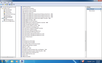

Sure, it is 7pro 64 bit. There are no errors in the device manager, only an unknown device. I belive SB or phone.

Hi again .. Only one Graphics Card is showing .. The NVIDIA seems to be missing .. Did you use the Lenovo website for your Drivers ?

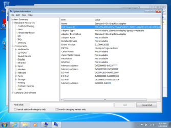

This is the worst. It will work out of now where, then the drivers update and boom, back to not seeing the whole screen. Please, any info woudl be great. I have done about 4 clean installs. Here is sysinfo.
