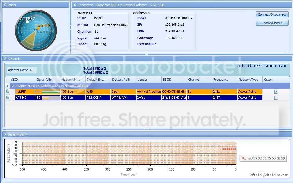

I had the same error again. This time I went into the event logs to find out what is happening. But first here is a screen shot of WiFi Inspector:
Here are the events leading up to my "Limited Access" problem. When it occurred this time I had been playing an online game although this happens even if I'm browsing, or sitting idle.

The signal strength and channel selection look fine.

I agree, WEP = No Security at all. No issue at all looking at the Xirrus capture.

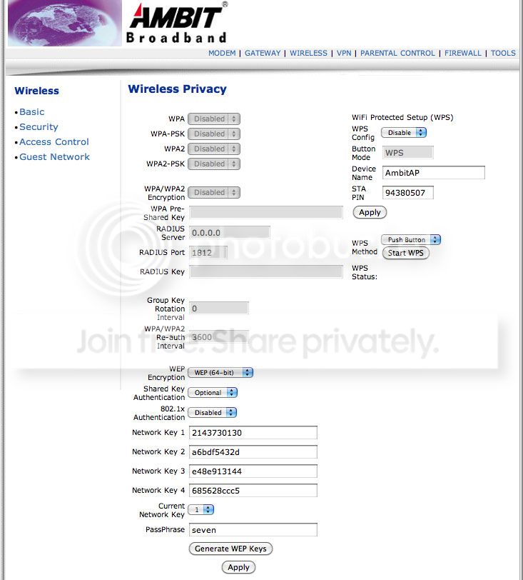

Maybe I'm missing something obvious here. When I login to my router (Ubee U10C022.010) the option for WPA-2 is grayed out.

The router is from 2008. I suppose it doesn't support WPA.

It says disabled at the top of the set up page there. You may need to disable WEP first.
I believe that you need to use a pass phrase with at least 8 letters or characters for WPA-2 to work. It's best to use a word that isn't in the dictionary.
