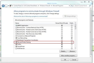

Check your firewall on Windows 7. Make sure it is allowed.
