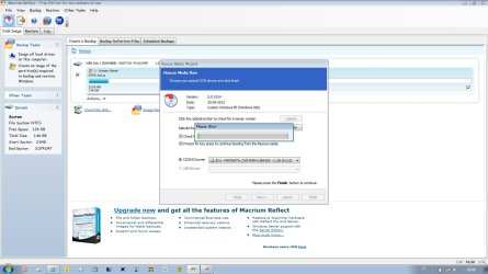

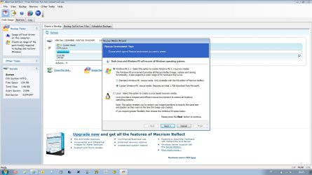

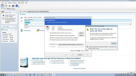

Please see pics (for the dvd)!
Same for the USB flash!
I have the WAIK installed in my ssd! (do not need to download it)
