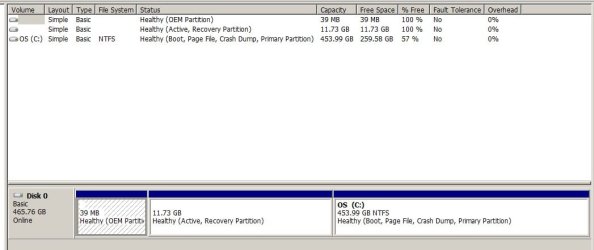

I guess the underlying problem is that I don't know how to find those flags on partitions. Disk Management doesn't seem to offer anything.
Win7-64 pro; XP
Dell (Precision, Dimension), Vaio, IBM Thinkpad
Win7-64 pro; XP
Okay, here it is. There are the verbal descriptions, but no flags, and no menu items suggesting that there's any such thing.
The odd thing I notice about this drive is that no partition is flagged as "system".
I don't know why that is.
I'd guess that boot files are on the OEM partition, since it's a Dell, but for some reason you don't see the "system" flag.

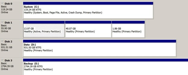

Mine is below.
Disk 0 is Windows and applications, containing all flags on this single C partition.
Disk 1 is Linux. Disk 2 is data. Disk 3 is data backup.

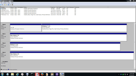

My understanding is with a Dell and maybe other branded computers System, Active, mean the same.
We need another person with a Dell to post a picture.
