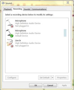

I do not see the bars moving in recording devices.
The mic is recognized though, I've attached a screen shot.

The first microphone device. Can you right click that and set it as default? Try that and see if you get microphone input.
It wont let me change it to default, it is for the rear jack which I have tried as well.
