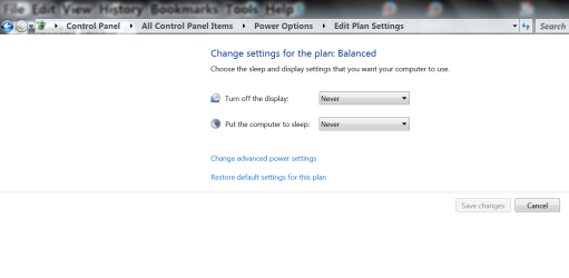

Because you have a 10 min.
thing going one, go here and try Never and Never.
It shouldn't have a effect right after booting but it cost nothing to try.
Jack
I already have both set to never
