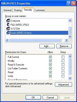

I assumed you've checked the NTFS permissions?
These are the permissions in the Security tab. Make sure group "Users" has modify permissions.

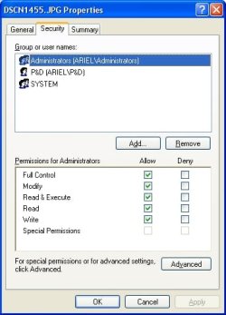

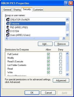

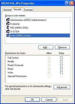

That was dead on. I did some checking between the good and bad files (on the XP machine) and lo-and-behold, the permissions were not the same. First I tried adding "Users" but got the same result. Then I tried adding "Everyone" and... bingo it works :)
Good File
Problem File

Now I want to know how to set the permissions for the rest of my files on the XP machine. The folder settings would have me believe that "Everyone" and "Users" were given full control. But that didn't happen. There's an Advance Settings box which seems to have some interesting options. Unfortunately I'm a bit confused about it right now.
Folder Settings for "Users"...
Folder Settings for "Everyone"...
