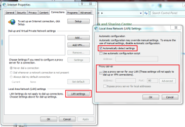

3, Open Control Panel > Network and Internet > Internet Options and under the Connections tab click Lan Settings and make sure that your settings match the image below
   Note
This will re-enable Internent access
