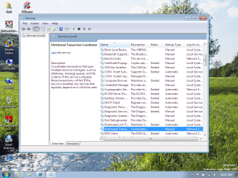

my instinct is telling me that he has a "infection" . I checked my own Task Manager and the processes and I dont have a msdt.exe. I looked in Services and noticed that the Distubuted Transaction Coordinator was set at manual.... maybe I should ask my friend to send me a pic of his Services and compare them?

See this from Sophos:
W32/Tilebot-BQ Win32 worm (W32/Opanki.worm.gen) - Sophos security analysis
Startup Type:This startup entry is installed as a Windows NT, 2000, 2003, XP, or Vista service.
Service Name:MSDTService Display
Name:Microsoft Distributed Transaction
If this is the path .... c:\windows\msdt.exe ... disable the service, then delete the file. You may have to go into safe mode.
