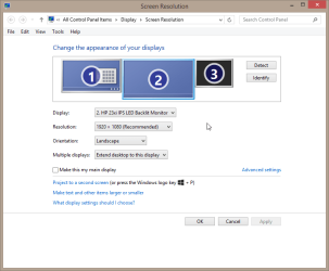

It's not odd, it's how it works. Here a screenshot of my setup:
All three displays found (1 = laptop, 2 = external HDMI, 3 = external VGA) but only two, any two, can be used at any given time.

This is what I see so I guess that was the confusion as it looks like you can. Do you know of any way to get three displays to work or am I wishing for too much?
