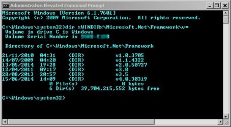

.NET Framework & iMacros
I have iMacros installed in Cyberfox and have no issues with it or .NET Framework.
.NET Framework versions on my machine:
If you like you could try the following:
Remove the iMacros extension and reboot. You don't say what browser(s) you're using with iMacros but if you've installed the Firefox add on run this to check for any possible leftovers:
https://addons.mozilla.org/en-US/firefox/addon/ecleaner/
If you're sure that iMacros has been fully removed - reboot and reinstall iMacros.
