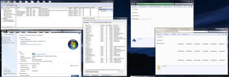

I have an on going issue with accessing my computer and thumbnails/icons failing to show. This has been happening for the last few weeks.
The first screen shot attached shows some details of my system and the problem at hand:
Everything seems to work fine after a fresh start up but after a short while, if i open my computer it shows up blank with a green bar that never reaches the end and a magnifying glass icon on each of the shortcut folders (favorites, libraries..).
In addition to this, if i access a folder by typing in the path or using another shortcut, all thumbnails and icons of files in that folder are missing.
If I end explorer and restart the process, it becomes worse and I'm unable to even access my computer or the control panel. Instead I get the following message:
::{26EE0668-A00A-44D7-9371-BEB064C98683}
The remote procedure call failed and did not execute.
However, if I restart the computer or even just log on and off, the problem goes away, but only temporally.
I have tried a system restore a while back to a point before the problem was apparent.
This did not fix it. :(
Has anyone else come across this and/or can help me please?!

Go to Services.msc and check if the Remote Procedure Call service is enabled.
Also, from task mgr, end explorer.exe and then click on File>New Task (Run) and type explorer.exe to restart the process.

I have checked and the remote procedure call service is running, and as mentioned in my previous post - restarting explorer is what causes the error message to appear in the first place. Logging off and on, or restarting will temporarily fix my initially stated problem.
Thank you for your reply, I followed the link and tried the solution. It doesn't really explain what the command does to your computer, but it seems to have done the trick! I haven't had the problem reoccur as of yet. (fingers crossed) Thanks again Jacee! (i'll give a a few days before I mark as solved)

PROBLEM HAS RETURNED out of nowhere! well I was saving a file in photoshop and the windows folder got stuck on reloading the new file's (png) thumbnail ...and now the green bar of death and everything I mentioned in my opening post is back.
this is so frustrating! :(

And the truth comes out.... SIIIIGHHH. Corrupt file.
OK for the record (for the next frustrated soul who stumbles on this thread) - I'd already done several malware scans and done a clean boot (no non-windows services and no startup items checked). SFC Scannow yielded no issues. If I killed explorer (using the start menu ctrl+shift+right click thing or thru the task manager just outright killing the process) and restarted it, yes I did get the "remote procedure call failed and did not execute". My explorer windows were doing forever-slow-load but not fully freezing on their own for the most part, however.
My windows error log for when things went wrong included VLC player crashing several times and taking windows explorer with it once. From then on explorer was doing the forever-load intermittently on "computer" and "control panel" and thumbnails (and even icons) were loading incorrectly in many folders. There were no other problems (not an instability/BSOD inducing thing).
I got the suggestion to make a new user account, which did not have these problems. In copying stuff from the old account a bit at a time, I found VLC player created a corrupt file the day it crashed several times while I converted a file. Every time explorer dealt with the folder that file was in, it began to lose its mind. Since that file was on my desktop, that was more or less all the time.
SOLUTION - I could delete the corrupt file in safe mode. All icons/thumbs are back and fine, and I imagine my slow computer/control panel window loads are not coming back either.
