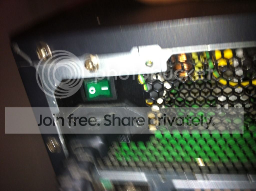

it wont turn on at all, the PSU at the back has a lighted switch on the back that flickers so im thinking that might be the problem, pehaps theres no constant power going through.

its a desktop, and its a custom pc that i built online through a website
this is the back of my PSU, that green power switch keeps flickering

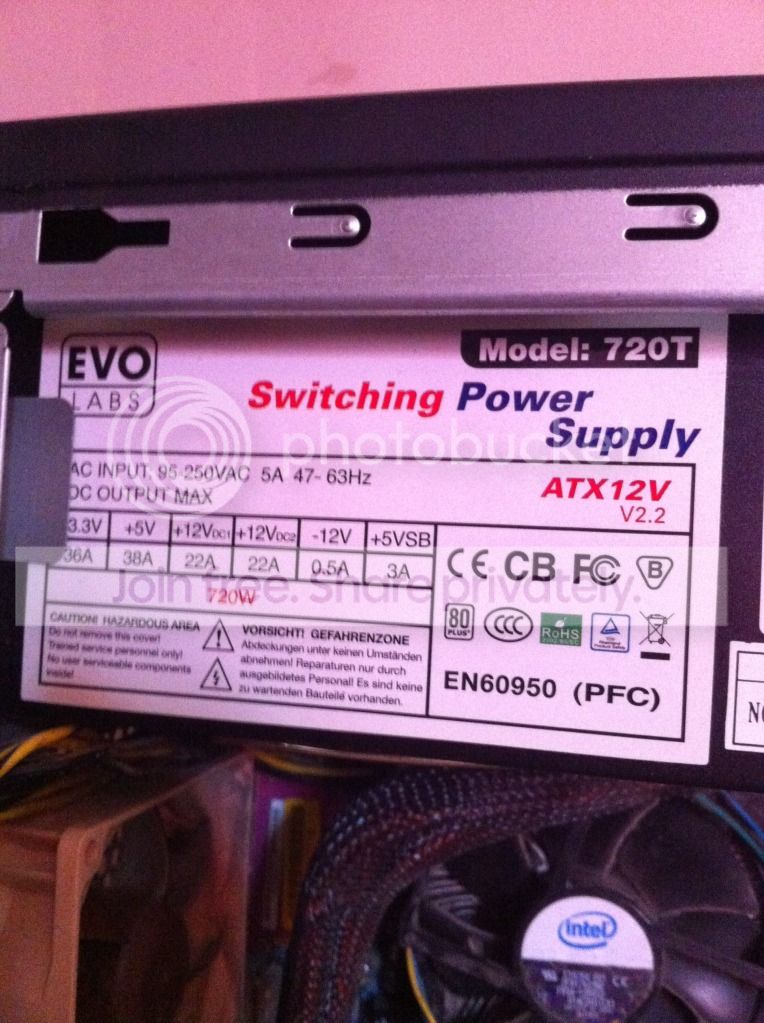

this is my PSU

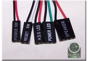

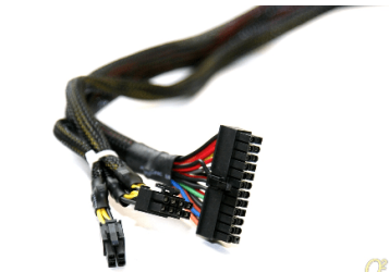

With the power cord disconnected, unplug & plug back in the 24 pin MB power connector, check the 2 wire on/off switch that is plugged in to the MB switch header. Also I have had that front panel on/off switch to go bad & had to replace it.

My advice still stands. In addition, check the connections to the front panel switches, as loose connections will obviously render the switch(es) inoperative.

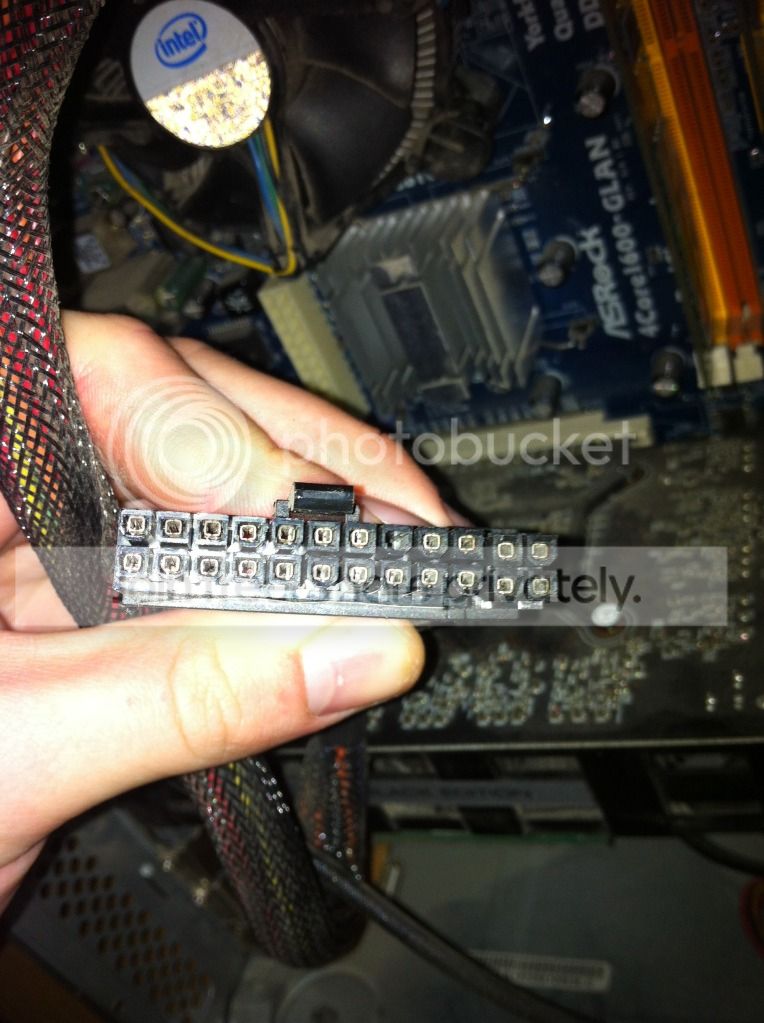

i unplugged the 24 pin power connecter... this one
but still nothing :(
when you say check the connections to the front panel switches, do you mean take the front of the tower off and check the main power button?

Low quality, no name power supply. Best I can find on it is either this,
Evo Labs - Envizage Solutions Ltd - PCs, Components & Media Players at low prices
or them going for even less on fleabay. No specs, no reviews, no actual manufacturer website, nothing.
I have a feeling that that PSU may have up and killed itself likely due to extremely low end components in it. If that is what has happened, it is time for a new good quality power supply and not something that no one has ever heard of. Also if that is what has happened, the next hope is that when the PSU killed itself it didn't fry any other components in the computer.

ive had that PSU for about 4 years so for an unknown cheap one i think ive been lucky with it for that long, i guess ill have to buy another one.
any recommedations?

To see if the psu will power on, you jumper the green wire on the 24pin connector to any black wire on the same connector. Unplug power to the hard drives first.
If you want to test the power switch, just plug the reset switch header to the power switch connector on the motherboard.

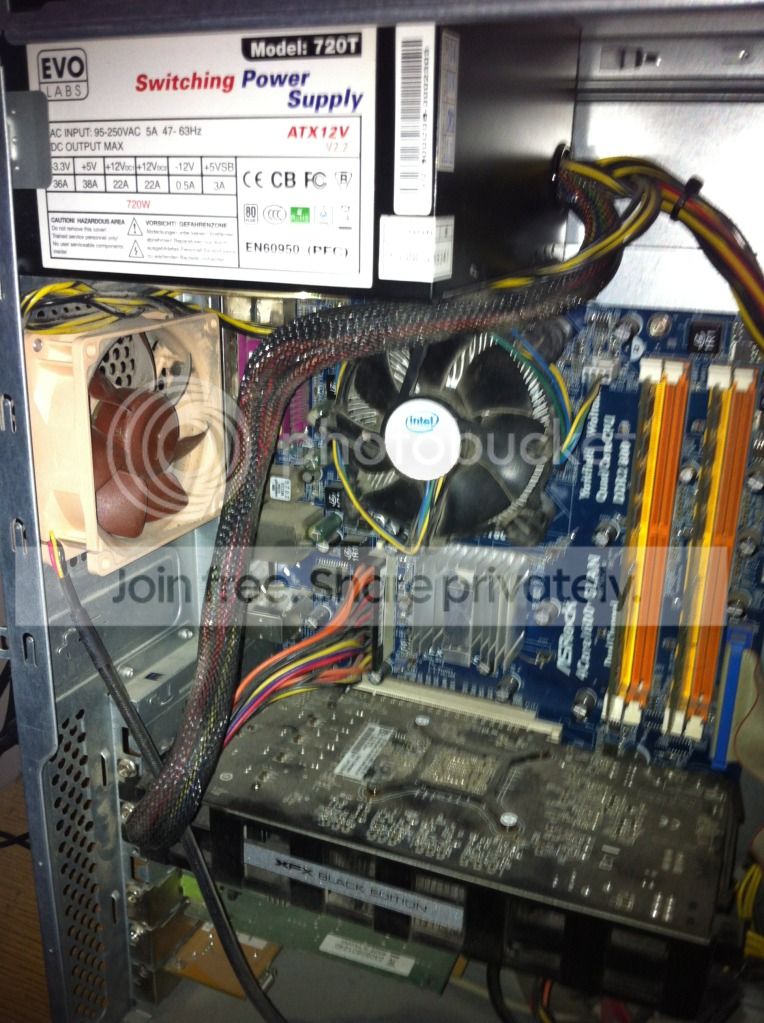

The other thing I've noticed is a lot of dust on the fan blades. I would as well as checking all connections and checking for the PSU I would use this chance as a time for a deep cleaning of the PSU by blowing it out from any and all sides, clean all fans and of course the CPU cooler and GPU. My gut is telling my this PSU has gone bad and it's time to replace but do all the steps suggested first and then go shopping for a Seasonic PSU.

You have a no name, no company, no reviews questionable 4 year old power supply. Whether it's your problem now or not. It will become one. Everything in a computer starts with a know quality powr supply. The names that come to mind are Corsair, Seasonic and Antec. Completely filling out your ((My System Specs)) will help us help you.

Check your specs I would recommend a 650W power supply as min. My reasoning is the listed min. is 500W for your video card. A 650W power supply won't break a sweat keeping up with your system. Their for it will put out less heat and a cleaner volt/amp signal. It will also give you room to grow if you want to add something later.
