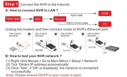

i just got a small pretty cool Network Video Recorder, cameras over network, less cabling better quality, i am happy with it, but id like to take advantage of the remote monitoring functions too.
The system has a LAN jack for the internet connection in the rear and in my house, the internet is provided by a wireless modem. the only port it has is a micro usb.
other than getting an additional service from my ISP only for that:cry:, what can i do?

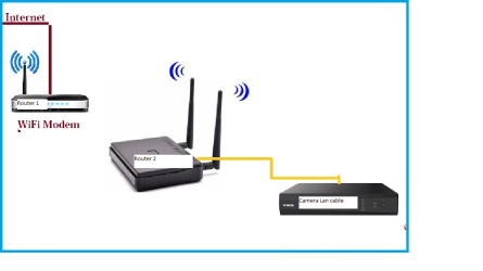

No
Cam > Lan of router 2 > Wifi router 2 >>>>> Wifi router 1 > Internet

ok, i will show you what i have.
The wifi modem (white), the router; has lan and wifi and the NVR

someone told me that i could solve it all with this:
https://www.amazon.com/gp/product/B0195Y0A42
I'm not sure it looks like it has an Ethernet port, For this to work it must have at least one Ethernet port for the camera to plug into, It more than likely would work.
Are you using the Belkin router for anything right now because if you can move it there are several tutorial's online that can show you how to make a wireless bridge with it.
How to Set Up a Wireless Bridge With a Belkin Wireless G Router | Chron.com
Google found a lot hits to do this.

Yes it has one ethernet port
no, i am not using the Belking router, so i can completely dedicate it for that, it would be perfect if it works for this
you gave me enough information about it i will see if i put it in practice this night, the only ting i am worried now is, about the configuration of the router, it needs a pc to access, and the camera system works without the pc, i guess i must configure it in a pc and once configured then to connect it to the camera system

I just looked up your belkin router it's very old technology ~2009, Although this will work I am not sure how reliable it will be, WiFi back then was not the best in the world.
You might have to downgrade the WiFi security settings on your white router to get the belkin to connect to it.
I would get it working with what you got right now and see how you like it but I would defiantly keep my eye's open for a good deal on a router, As fo that TP-Link N300 Wifi Extender you linked to I would personally buy one that's a bit better, One with more LAN ports and probably closer to the $50 price tag -- You get what you pay for.

yeah its pretty old, and yes it is reliable, i bought that in order to replace a lot more modern netgear i had, the netgear constantly had signal drop and constant reset of the settings and was common in those netgear then i got that older belking, not the fastest but for the service i have contracted from my ISP for that time, and EVEN NOW the speed is fine.
