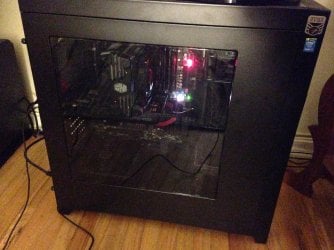

And one of my rig

Darn,
I believe you have my case too :p
Is it a Corsair 450D or it's big brother I believe the 750D ?

You do show a red light on the ram ?
Or is that the camera's flash ?

Yup. Same case. 450D and I must say, it's an awesome case. Very happy with it.
The red light is actually the cpu temp which is on the mobo. I just didn't focus very well, lol. Says 40 though.
I suppose 40c isn't bad for a air cpu cooler my other build shows 38c most of the time.
Please let us know that is pretty weird my install went way too easy :shock:
