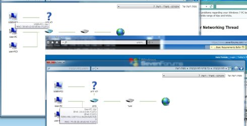

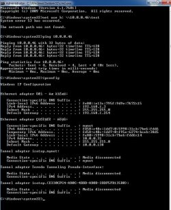

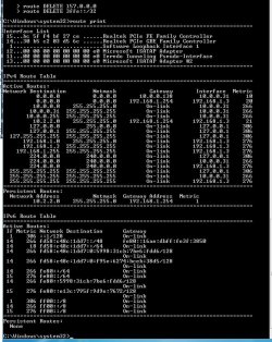

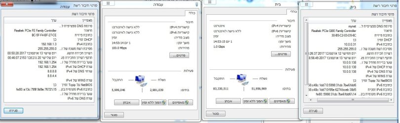

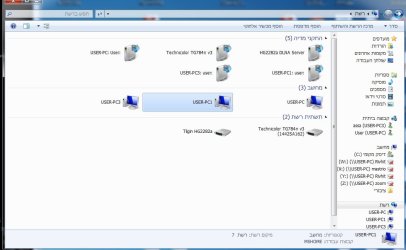

Hello All,
I have a problem with my network configuration on two networks,
Network 1: 3 computers connected to a modem/router of my ISP - router is the DHPC (10.0.0.138)
Network 2: 1 of the above computers (user-PC1), with seperate modem/router connected to work - DHPC (192.168.1.254)
all connection are dsl over phone lines (separate lines).
Since the new connection to work I can't see any of the other computers, access any shered drives and pure bizarr in network map I can't access my computer.
Information:
Y computer: user-PC1 (see in pic)
1. all computers can ping each other.
2. I can access my computer and shared drives from other computers.
3. when trying to access my computer in network map I can acsses my computer but not others.
4. when trying to access computers in network (network devices) i can't access all computers include mine (user-PC1) - with an error: network provider is not
Thank all for your quick help !!! :D

Welcome to the forum. I assume your from australia as all your photos are upside down? The pc on the work network how is that connected to the rest of the network 1? As its on another ip range it wont see other pcs

hi,
First I'm from Israel :)
I have two dsl modem/router connected to two separate phone line so I have separate networks 10.X.X.X and 192.168.1.254
My problem is since the installation of the second network (192.X.X.X) I can't see any other computers or drive shares in the other network (10.X.X.X), I don't want to connect between the two networks.
As I wrote before pinging from any 10.X.X.X computer to another is good, I can access the internet from any computer through the modem on 10.X.X.X .
I can only see all computers and share drives from the other 2 computers on the 10.x.x.x network, also can see shares on my computer from the other two.
Although in network device I can see all computers I can't access them -also can't access mine.

You didn't answer how is the 192 PC connected to the 10 network?

hi,
1 computer OS:windows 7, two network cards.
