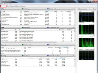

Click Start and type in the search box
resource monitor
Hit the enter key or click on the suggestion
You should land on the Overview page post a screen shot so we might see what is going on
Most common cause lately has been svchost.exe acting up so if you see that on the top of the cpu list see if these windows updates are installed KB3020369 & KB3172605
If not manually install them.

followed your suggestion and when resource monitor opens the window is empty? I have disabled windows update becasue it was not working since then a noticeable imprisonment in CPU usage.
