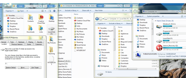

Need to UNDO a "Folder:Properties:Location:Move" made in error
I am a novice that has run into trouble with Location “ move” tools Folder: Properties: Location: Move).I have tried Googling the issue, but I am not exactly sure what I have done.
I am rebuilding my laptop which has a medium size SSD and a 1Tb hard drive running Windows 7 Professional 64.I have much of my software installed to the SSD C:, some installed to a small partition on D: on the 1TB disk, and my files to a second partition on F: on the 1TB disk.
My Dropbox is in F, and I successfully used the “Location” tool to move my “Downloads” folder to F.
1.I went to move my Favorites folder with the location tool and fat-brained/fat fingered something and I found the individual elements (items and subfolders) of my Favorites folder in F without being part of the folder Favorites.
2.There was an option to return to the “default” which I assumed was like “Undo”.As usual it was a bad idea.My individual "Favorites" stayed on the F Drive, and copy of the F Drive appeared in my user folder.
3.I now have a “Local Disk F: ” in my User Folder on C:, but luckily it is not “taking up space” on C:.I cannot delete it or drag it.I also have my Favorites (items and subfolders) on F: with out a Favorites Folder.
4.One more unusual note…. In one view of my User folder I see “Local Disk F:”, but when I go through Windows: User: I do not see “Local Disk f:”See attached screenshot to see that circumstance and for additional illustration of my issue.I masked my actual user name to protect the ignorant (me).
I wish to:
1.Remove the “Local Disk F:” from my User Folder
2.Remove the individual elements of My Favorites from Local Disk F and place them back where they belong in the Favorites Folder.
Thanks in advance, and if the answer exists on this forum already I am not savvy enough to identify it.

Press "restore default". What happens with the location if you do that?

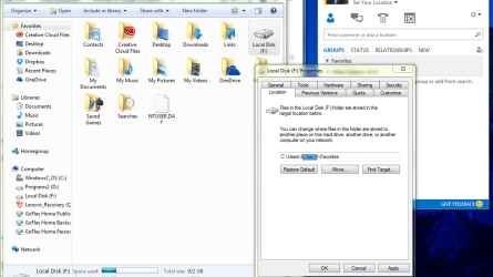

I did and nothing happens. However your question yields another clue that may help solve my issue. When I right click on the icon "Local Disk F: in the user folder it reveals that it is stored in C:\User\UserName\Favorites. Please see screen shot.

So it's the favorites thing you changes. Press "restore default" there and press OK (don't press MOVE!!)
What is in folder C:\users\<youraccount>\Favorites afterwards?
Rename "Local Disk (F)" as shown in your screenshot to "My Favorites"
Post screenshot
