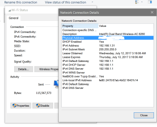

what is your Details info like this?

Hello. Finally got a chance to log in tonight. Here are the specs:
[/URL][/IMG]
[/URL][/IMG]
Looks normal to me but I could be missing something!
