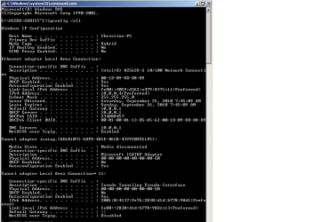

I have included screen shots of her IPCONFIG in its working and non-working states.
To be clear. The router is working. The network cable is working. Her hardware is working. I believe that there is something in her installation of the software that is not configured correctly that is not initializing the network stack correctly. That is what I meant by "wrong with the OS".

Dave, those ipconfig's certainly aren't correct. The default gateway is coming from the modem I believe because the default gateway for your router is suppposed to be 192.168.1.1 and the IP should be a variation of that default gateway, not 10.0.0.1, which is usually reserved for Cisco bussiness class routers. This usually means that there is a conflict between the modem and the router.
Are you sure that the problem machines isn't plugged into the WAN port on the router?
There are similar reports of this problem with your same model of router and apparently to fix it the modem needs to be set to bridge mode only.
http://forum1.netgear.com/showthread.php?t=35054
I would go through the router-modem set up procedure again because the address doesn't seem to be coming from the router at this point.
